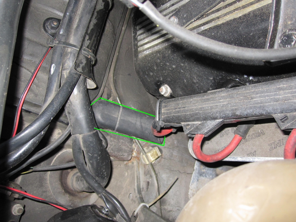

              anyone have a picture of the tubes? I can't figure out what I'm supposed to be looking for

                OP's issue looks like a bad door seal to me, is that the consensus here? OP, I would consider replacing the seal on the door itself before the one around the door frame; the one on the door should be able to keep the water out if it's coming in exclusively from the top. It's a lot cheaper, too.
                Snou, they look like this:
                One on each side.
