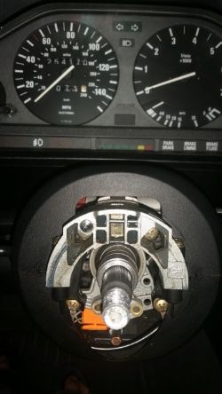

        It's probably something simple that you are missing because the swap is pretty straightforward. Did you remove the white plastic peg from the column? The brass tab you are talking about I assume is the horn contact. It must make contact with the ring in the wheel for your horn button to work. Take a picture of the wheel and column.

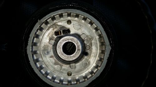

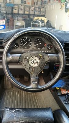

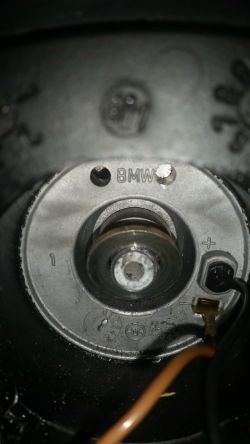

                I should have specified...let's see the steering wheel.
                88 M3 - LACHSSILBER
                89 M3 - ALPINEWEISS II
                • SLCE30318is
                  • Sep 2014
                  • 83
                  Oops that's my bad. Here are the photos of my steering wheel:
                  • reelizmpro
                    • 9558
                    You are missing the plastic horn contact ring! The screws are there but the ring is gone. Good news is you can use one off any non airbag wheel.
