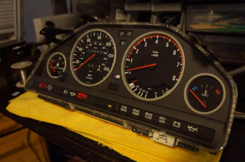

    You can check with Bavarian Restorations, I just got my cluster redone by them. I went more classic but they can do just about anything. I added Oil Temp and Volt meter.

          Really depends on the options, mine was around $600 for everything if remember correctly. That includes full refurb of the cluster, complete cleanup and solder of board, new batteries, new lighting, new gears in the ODO, fixed my brokn clips, new bulbs, gauge rings, new coding and raising my tach to 8000 rpm, Alpina strip, volt and oil temp gauges.
          You can do it all or go alacart, if your cluster is in good shape you can just have them add the small parts and its much cheaper. Since I am doing a full restore on my car I wanted it like new.

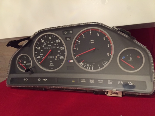

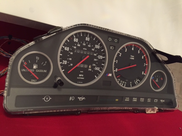

              Cluster came in today, I am installing this weekend, few more pics.
