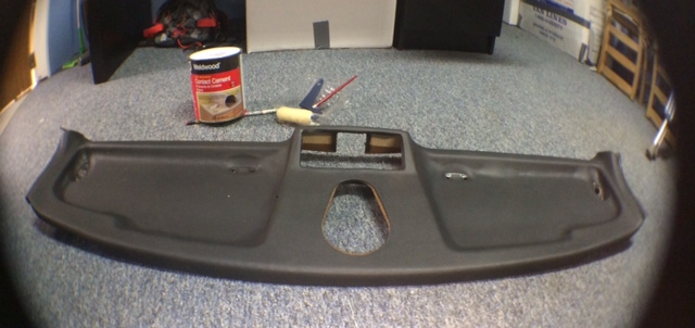

    Headlining Cover
    Has anyone had any luck glueing the vinyl back to the cardboard/fiberglass?

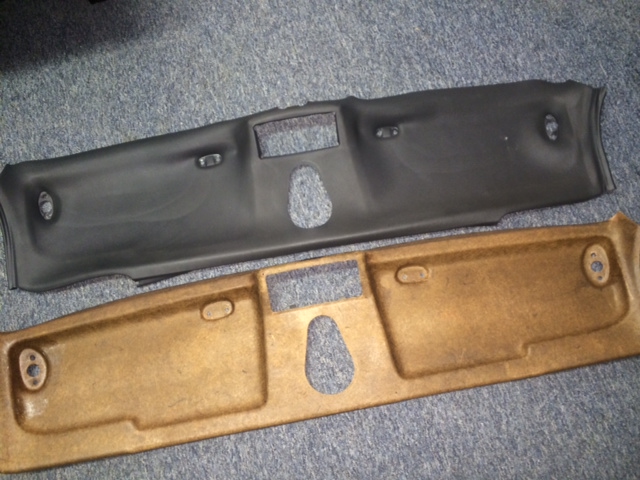

        Thanks Kershaw, this is all good advice.
        I really wish I would have seen it before giving it a go. My father also told me about preglueing both sides... I guess thats how they do vinyl countertops. Of course his little tidbit came afterwords as well.
        This was my finished product:
        I think I was fighting an uphill battle to begin with. The vinyl had shrunken pretty badly in the front due to sun exposure. It looks better than it did, so I'm happy about that.
        My main problem was that I didn't use enough glue, and only applied it to the fiberboard side. I'd like to give it another shot with new vinyl at some point. Never really knew about the intricacies of interior work until now.
