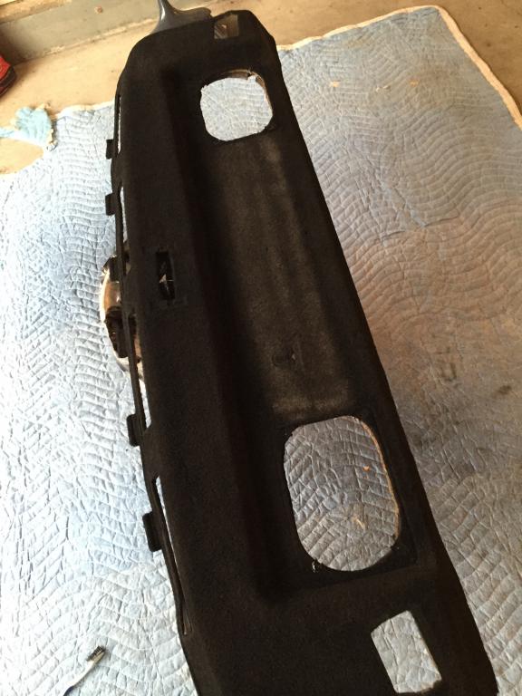

    Soooo I've been on a mission to hunt black interior pieces but here in California, it's pretty impossible to find em. And if u do, u have to pay a pretty penny for it. So I went with the duplicolor route, and it works great on the door cards. I did 3 coats and after it cured, it almost felt like my door cards came black from factory. But the issue comes with the rear shelf. It was vaccumed and cleaned and throughly dried. Did 4 heavy coats with about 20-30 min dry time in between... For the most part, all was good. Black as fresh tar poured on a pothole. But then there's one part in the middle of the rear shelf that doesn't seem to want to accept the paint (see pics). Any help, tricks or advice would be appreciated. Thanks in advance!

          Yea man. It's good stuff. Here's a tip, I used the duplicity paint prep cleaner (same air drying effect as brake cleaner). But it's important that u clean twice or 3 times to get all grease out. And even more importantly, wipe dry and let air dry for a while. I made mine air dry for 30 mins after I dried with a clean cloth. Reason being is that for some reason, after I painted after wiping dry, some spots were bubbling. Almost like it was breathing or it had pores. I know, weird but that's how it felt. I left to get my son from school and came back about half an hour and painted the other door card and it went on with no problems. So I sprayed another coat on the other card that was bubbling and the paint went on smooth. Doesn't look like it was painted at all. Take ur time prepping, and ur results will come out awesome!

            I vaccumed, and cleaned with an auto upholstery cleaner as suggested on another post and let dry. I can dismiss the cleaner or my cleaning method as the culprit cause I cleaned the whole deck the same way. But for some odd reason, only that spot was rejecting (or sucking in) the paint. After it dried, I payed another coat and its seems to have gotten darker. I'll lay another coat down tomorrow when I have sunlight... I'll let u know how it goes.

                  I have sprayed a rear deck with the same stuff and didn't have any problems. Maybe oil or something was soiled in the center? Try flocking it and spray several coats from different angles.
                    Flocking? I'm aware of the process but is there another process of flocking the fabric that's already there? Or do u mean do the actual flocking method which requires the purchase of flocking material?

                              On the rear deck, do several light coats and see if that covers the "mystery" spot.
