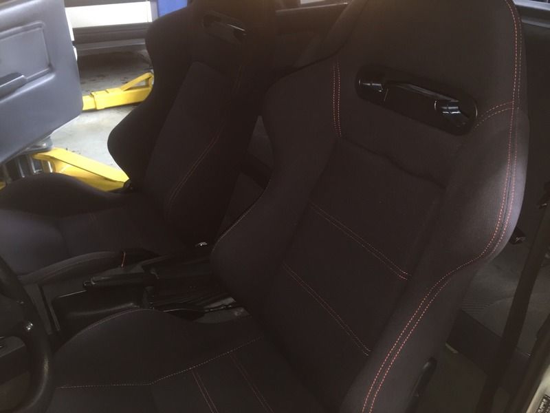

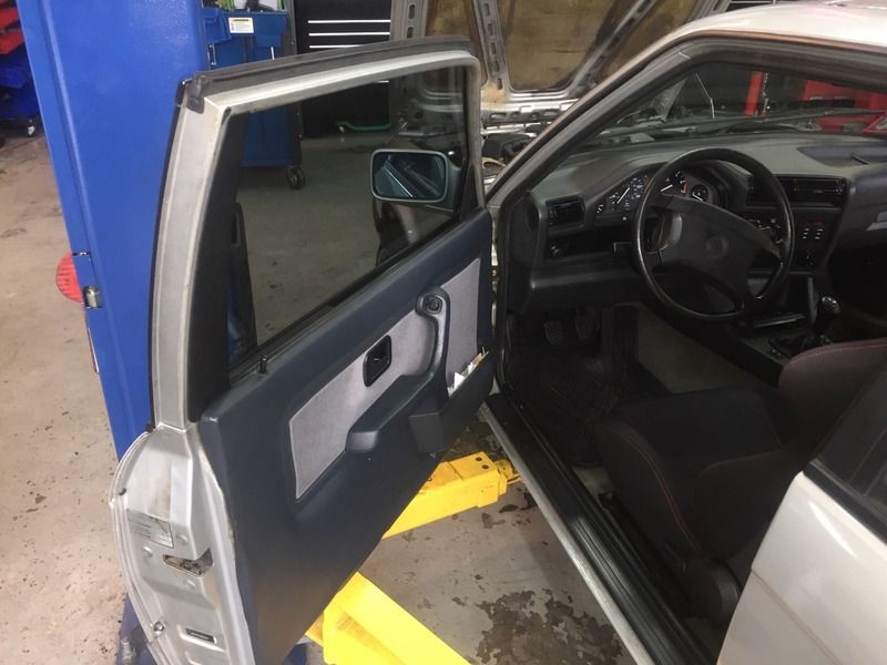

    Here's how she looked the day it rolled in...shitty broken ebay racing seats with homemade mounting brackets bolted to the floor with 2 of 4 bolts (yikes), a back seat that looks like two werewolves had been mating on it, loose steering wheel as the rubber had become unglued from the metal wheel itself, and just loose and rattling pieces of plastic trim all over the place. No stereo, and it was just tattered and tired. the door panels were poorly mounted with half-ass intentions, and any number of other hackery. I'll be ridding the car of any ebay crap, and making it as pristine as possible with a reasonable budget (not cheap but not show quality).

    A couple extra photos from my iPhone. Showing tattered back seat, black interior that'll be going in, and present condition with dash and interior

                I agree...the seats don't LOOK bad...so I figured I'd end up keeping them in the car. Problem is the guy didn't spring the extra $ for proper seat brackets and welded up his own (he was NOT an experienced welder). The passenger seat slider is broken also and would not slide forward or backward. The seats are very uncomfortable as well and since this car will be my daily there's no way I could look forward to my drive home after a long stressful day at work while bouncing around in these rock-hard "racing seats." The OEM sport seats are a welcome addition.
