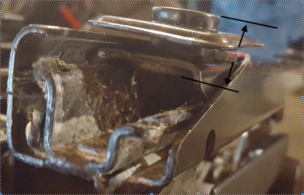

      The first pic shows the drivers side rear mounting point for the seat rail. From the bottom to the top of the tube that fits over the stud is 19mm. Add 8mm for the nut and 1 mm for the wavy washer and I need a 28 mm stud to get full thread engagement.

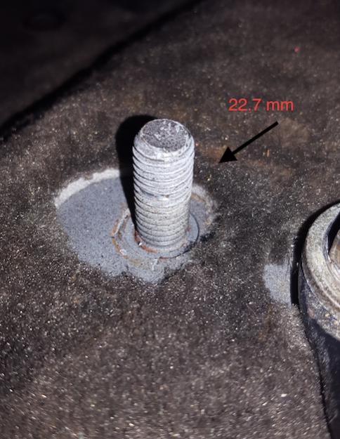

      Problem is that the stud )see pic 2) is only 22.7 mm long. That leaves me a whole 5.3 mm short.
      The standoff part of the tube (the part that stick out below the rail) is 4.5 mm. Plan A is to grind down that standoff so the rail sits flat on the floor, and lose the wavy washer. It's not ideal.
      Plan B is to grind down the stud, drill it out, and use a bolt through the floor. Also not ideal. There are brake line down below, those will have to be moved.
      The front issue is not as bad, The total length of the mounting tube is only 16mm, so I only need 2.3 mm more length. I can file the standoffs down and still have some..well...standoff.

        dang stud photo wouldn't load...try again..

              I'm quite sure that drilling out those studs will cause more problems than it fixes

                I would grind down the standoff on the seat bracket. It doesn't add anything but height to the seat rails. Take it down to the square metal plate. That should give you 4-5mm.

                      Its an '84-'85 problem, the seat bases on '86+ cars are thicker. I ground down the standoff to fit my sport seats in. if you want to do it with no hassle find the seats out of an '84 325e, they all came with sport seats with the correct thinner base

                          Had the same issue with installing my 89 comfort seats in my 84 before I sold it. The 84 Sport Seats fit fine in my 89. Caution on grinding down the lower base. On mine it created a clearance issue with carpet and the adjuster did not work properly. I tried pounding out the stud and using a longer bolt, That is a pain also because they are tack welded in place. Also minimal access from under car to reinstall. Find a happy medium when you grind.
