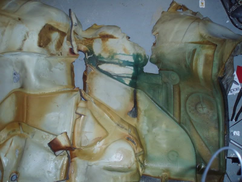

    any way here is picture of wet carpet
    as you see it leak some thing green i think

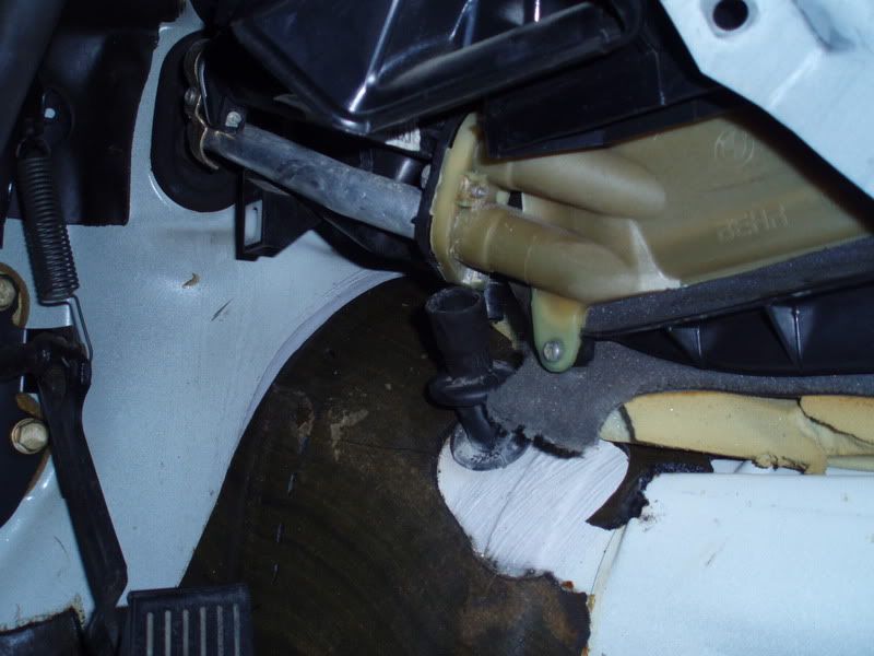

    here more pictur[img] where do you think leak is coming from
    [img]
    [img]

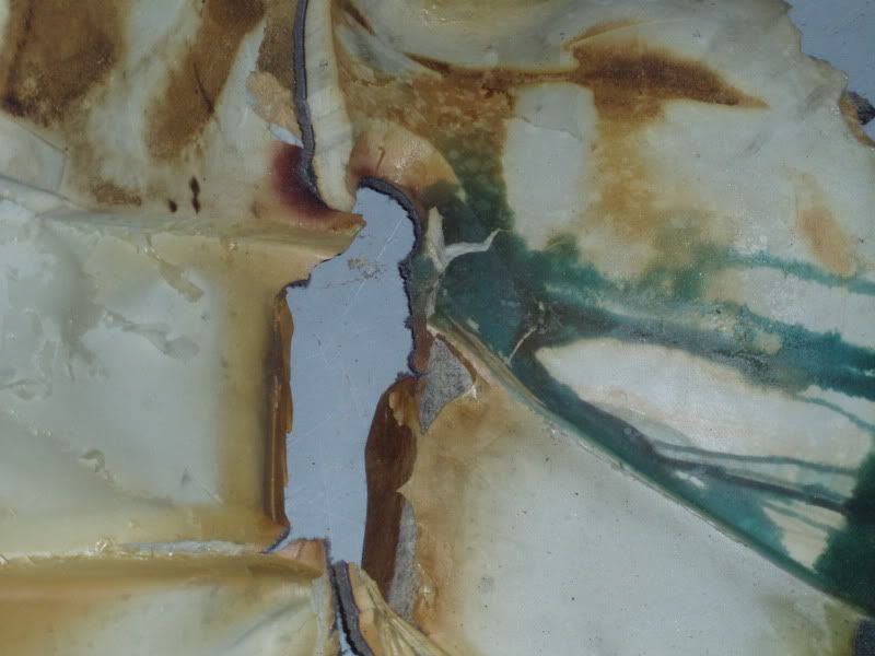

    close up I think it leaking some where in middle of dash correct ..
    I hope pictures help also how do I dry carpet right now is in my floor drying up ...[/img]

        heater core? do you use green coolant?
        • PeaveyBassist
          • Sep 2004
          • 3511
          Heater core or heater valves but I would say its more likely the heater core itself. BMW coolant.

            Antifreeze doesn't real evaporate, so you may need to rinse out the coolant on the carpet before re-installing.

                Ok I found the problem I had a loose hose maybe it became loose when I remove center console
                thank GOd problem fixed I started car up and blasted the heat no more leaks ...
