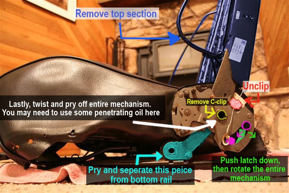

    i'm having trouble getting the bottom side bolster free. how do i get the hinge point in the seat apart? is there a DIY write-up somewhere? i couldn't find anything on r3v.
    as far as i can tell, the hinge goes through a hole in the bolster.
    this is where i'm at right now...

            the circlip
            you need a circlip plier, everything else is pretty easy, take the circlip off and just do it with some deduction, but the first thing is the clips.
            the one on R3V is accurate, but without picture is like trying to interpret words to something you never seen... pretty impossible, after I done it, i'm looking at it like.. uh huh uh huh, but before its just a jumble mumble of words.

              Bumping this up as it's a good thread thanks to that pic. made a worlds of difference while I was taking mine apart today.
