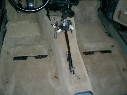

    Rug Doctor and Duplicolor Fabric and Vinyl has rejuvenated a $2.99 salvage yard oem carpet. The results were simply amazing.
    The PO of my cabrio had glued replacement carpet on top of the existing carpet, so I tossed both and started over. Obviously, I pulled the whole interior out to shampoo and dye the carpet. I took several days for it to dry.
    The armrest I scored for $100 was totally worth it too. :D

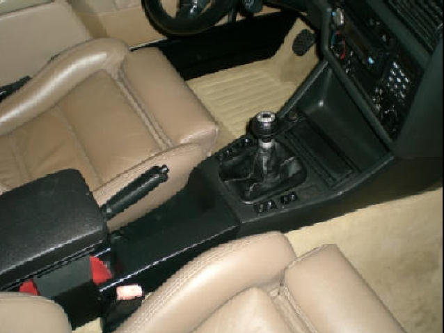

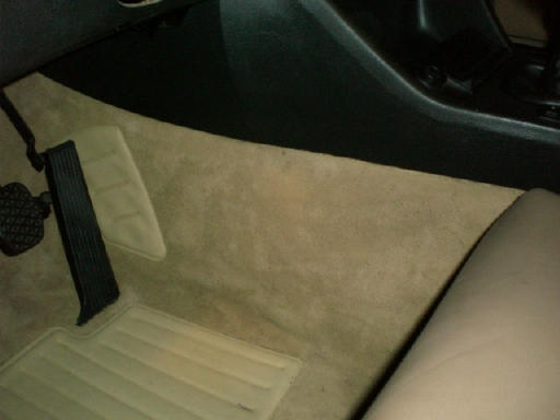

      Here are some pictures. I used Desert Tan Duplicolor. It was the only tan color, so it was an easy choice. It is nice to be able to stay with the velour carpet. The carpet samples I recieved from the aftermarket companies was cheap.

        That carpet actually look good in that color.

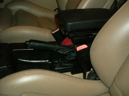

          Hey Thanks. I am really digging the armrest. It is at the perfect height and doesn't get in the way of shifting.

              There was a nasty carpet stain on the passenger side of this carpet too. What Rug Doctor didn't get, the dye paint did. It really looks like 'new'.
