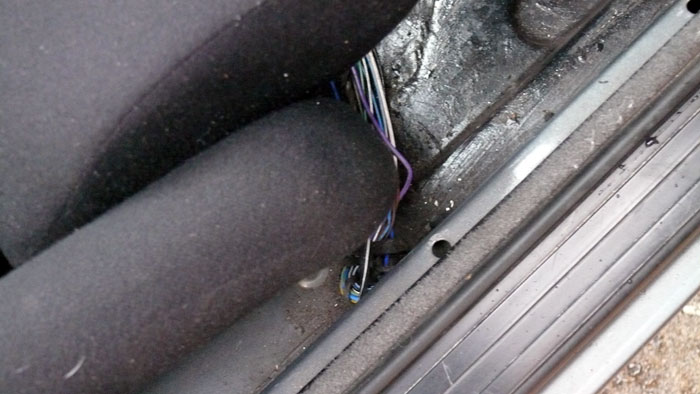

          I didn't want to spend more than I had to on new seats that can be used as DD seats and safe for AutoX/HPDE events / harness use etc.. I like them, yes they aren't Recaros but they do their job just fine for everyday use and hold me better than the old stockers (cloth oem sports).
          So, they were about 800 for a pair new with all the hardware / double locking sliders shipped. They do sit lower than stock sport seats, maybe 1-2" or so, I did not measure this.
          brackets / sliders
          for now using stock belts

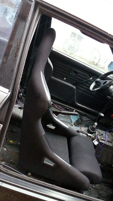

              at the moment my car is a work in progress.... but i have test mounted my recaro pole position SPG's with custom floor mounts made by my friend Uwe in england.
              it's LOW, i had to lower my dash and stearing colum to accomidate...

                Why not just raise the seat a little instead of dropping dash?

                    cause there is nothing under the dash, and i was dropping the stearing colum anyways, so why not?

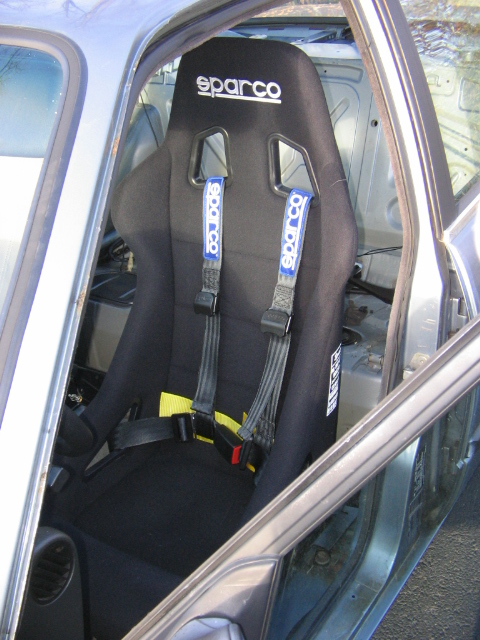

                      Sparco Sprint
                      I'm 5'8" and it sits a little low even with a slider and 0.5" spacers. I find myself pushing on the dead pedal to get a little extra height. Lowering the column and dash is an interesting option I may look into. The mounting bracket does not have a recline adjustment so I would not daily drive with this seat. My back feels strained after a full day of driving in such an upright position. I plan on installing a cage with proper harness bar and 5 point harness.

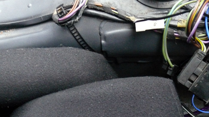

                          Hey jean can you snap a pic of how close the seat is to the center console? Im a bigger guy and i was wondering if the seat would fit. Thanks.

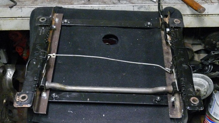

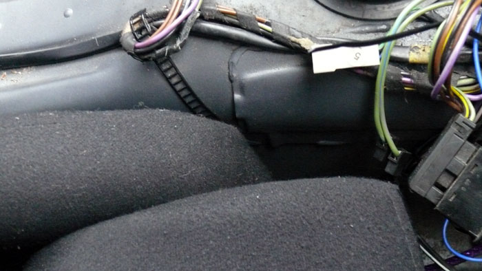

                            Corbeau Forza II using stock sliders
                            I put a pair of forzas in, on the drivers side I simply used two pieces of angle iron, basically like this. You have to drill holes for the seat and to bolt it to the floor pan, you also need a shorter bolt on the outside or the stock one will hit your fuel lines. Mine is set about 1" above the floor pan.
                            For the passenger side I wanted a slider so I can still get things into the back seat, I took the sliders off my old seats and again using some angle iron I fabbed up a little bracket, drill a few holes, add a few bolts and washers and voila. You retain the stock seatbelt location as well. It is about as high as a sport seat on it's lowest setting.
                            It's a tight fit, but I wanted the seats as close to the middle of the car as possible.
                            Here is a picture that shows the difference between the two seats.
