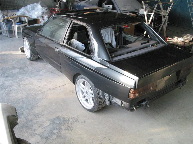

    I want a rear speaker shelf w/o a 3rd brake light, but at the same time I want a premium one and I found that the e30m3 shelf looks like exactly what I want.
    Would it fit a regular e30?
    (thanks to the op for the picture:)
  • Jean
    • 18228
    The m3 has more room "behind" the speaker shelf, but I wonder if the speake shelf itself is the same shape/size...
