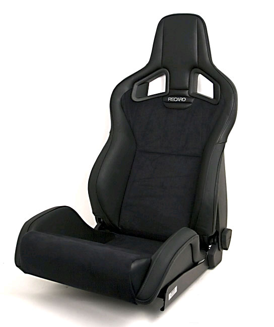

                0r $1,499 for these Recaro Sportster CS not that much different and a great price they are avalable at VAC Motorsports
