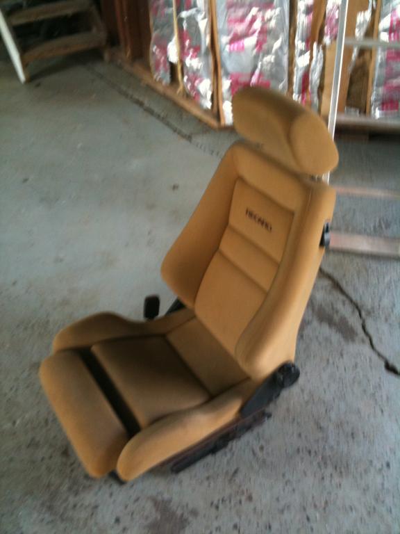

                  Just took this out of storage, single driver with e30 mounts already on.

                    Damn, if I could find a pair of those, I would have stuck with tan interior.
