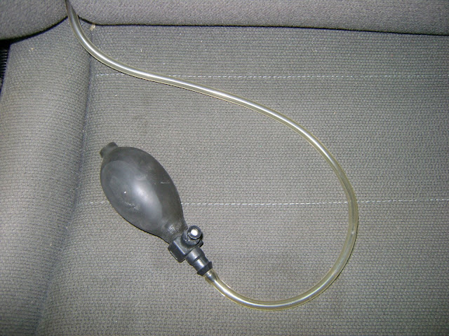

                Originally posted by Kwaaahhh
                Have you guys seen this, built in bladder pump for lumbar support :p (talk about old skool):
                :up:
                I'm so glad I stumbled upon this thread. I have 3 Recaro SE seats. Acquired one in a trade and it has had this clear tube tucked in the side and I never knew what it was for! WOOT WOOT Time to go find a little pump!

                  Inflatable Lumbar used to be very common prior to power seats. Look through some old school parts catalogs and you will see it listed.
                  It is still available. The site listed below has them.
                  http://www.motorsportseats.com/corbe.../Lumbar_lg.jpg
