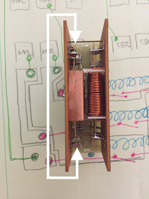

            Here is the light control module; though, it's for an older E30. The red-wire coil wraps around the relay. You can solder a wire between the relay contacts bypassing it, as if the relay is always on.
            I got the picture from here: https://e30journey.blogspot.com/2017...ake-light.html
            Connect a low beam bulb to the battery directly. If it's brighter, then you have a resistance somewhere in the circuit: a bad socket or wire contact, an old relay, etc.
            Measure the voltage between the battery terminals and at the front between the bulb terminals.
