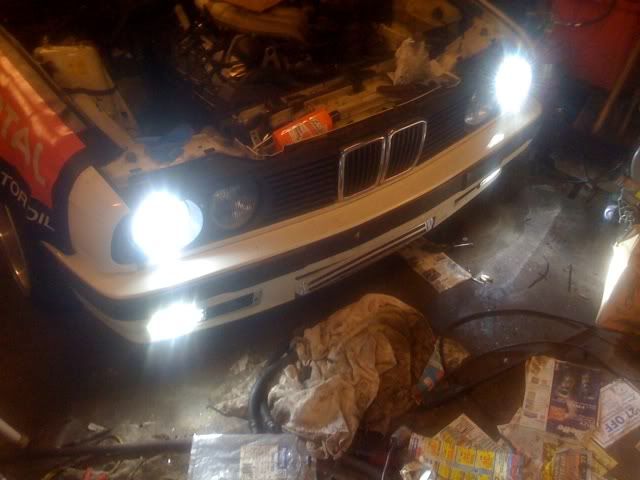

                    What you have to remember is that your 55W low beams will wash out some of the color. So imagine that a 55W@8000K is more like a 35W@6000K
                    I run lows at 55W 8000K
                    and fogs at 35W 6000K
                    looks like this.
                      looks like this.
                      Based on that, if the low beams are 55w @ 5000K, what would fogs be? BTW your match looks good.
