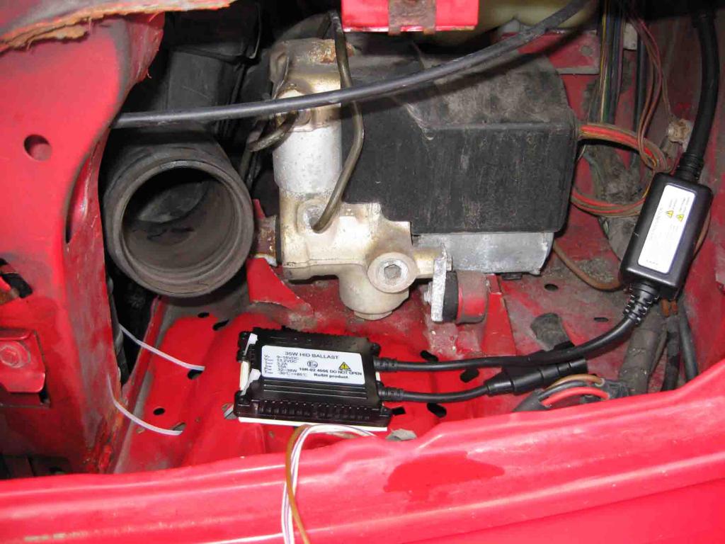

              I just got my HIDs and installed them.
              Only problem I had was that I didn't know where to put the amp things, so I just put them behind the lights. Should I leave them there or will they get too hot?

              • EA8
                • 328
                if you look right behind the lights, you'll see a small open space that you can just zip tie the ballasts too and call it a day ...

                • e30_kid
                  • Nov 2008
                  • 197
                  or depending on how much wire you have you can use velcro to put them on the tire wells like i did
                  • Alkasquawlik
                    • 4557
                    Did you put them inside the plastic cover that you put behind the lights, or did you have them outside? I have an iX, so I don't have as much space as you regular E30 guys

                    • EA8
                      • 328
                      i've got a 91 ix and I just did away with those covers and put them on the metal right under the headlights. The picture shows where I put the ballast on the driver side of my ix ... yes I know its dirty, but its a work in progress.
                      hope this helps stud ... cheers
                      • cobraken
                        • Oct 2004
                        • 674
                        Great pick, do you have any photos of how the wires connect? I have 3 wires on my car harness and only two connecting to the HID's. I tried every combination to get them to work and couldnt figure it out.
