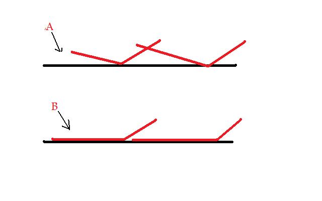

    As for aiming, I have US ellips, and didn't really fiddle with them after installing, but now that I have HID's and lowered the car, I wanna re-aim them properly so I can hopefully see further down the road...
    The current pattern is A, and I think according to Daniel Stern's site, I want it to look like B. If this is correct, awesome.... Can you guys specificy which adjuster does which on the ellips?

        you can't change the cutout pattern on the lights. that's done inside the reflector.

          I understand that, I'm just curious if it's possible to balance things out a little more. The right side is good, but the left is a little low and to the left... It's livable, I'm more interested in fixing my fogs

            right, but what you are talking about in those pictures is the shape of the cutouts. you can't really rotate E30 housings (except for LHD and RHD patterns). Plus, US ellipsoids don't have either of those patterns.

                yeah US ellipsoids are more like _- than _/

                    Yea US ellips patterns dont look like that. If they are euros make sure all 3 screws holding on the reflector are there and tight. The adjusters don't let them rotate </>/up/dwn thats it.

                      Hmmmm. I know I have US ellips. There are 2 adjusters per light, 4 per bracket. Like I said, I'll take my camera with me tonight, and try to get a good pic of the beams.. Maybe they're perfectly fine, but I'd like some clarification..
