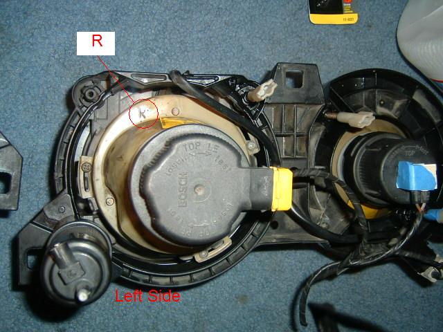

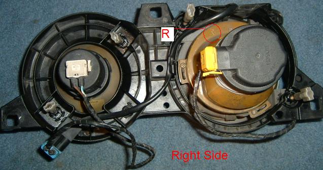

    Are the reflectors and glass the same right and left side? I just got a set of used ellipsoid and notice that the back of both reflectors is stamped R.

      Bump with pictures of my problem

            R = Righthand drive per e30zone

                  You'll be fine. Just rotate the back of it and it converts to LHD. I had to do it to mine when I bought some from the UK. All ellipsoids can convert between LHD and RHD beam patterns. Just loosen the 3 screws on the back of the part holding the lens and rotate it all the way to the other side of the slits.
                    that's what I was going to say. and actually where I drive (99% on the freeway in the left lane) it's almost better to have the RHD pattern. :P
                    sucks as far as streetsigns go though.. can't wait to ditch my depo's.

                      that is not the R that stands for the RHD. there should be a RHD marked on the outside by one of the 3 screws. you just turn the rear part to make it for a RHD country. It looks to me like you have 2 right side rears! shouldnt make that much of a difference. not one that you will notice driving, maybe the people coming at you though.
