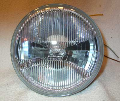

          You might be alot happier with better lights, not necessarily elipsoids. I get lots of questions from folks *with* elipsoids that want better light output, and I would be happy to suggest you look at some Hella upgrade units such as the Bi-Focus Low beams. Ever since the Cibie/Valeo CSR went out of production these are considered the best 5.75" low beam replacement.
          Anyone with sealed beams is likely to want better lights up front, I understand completely.
          The Bi-Focus was a joint development effort between BMW and Hella back in the early 80's and is a far superior light to the elipsoids, with more even spread, better output, and WWWAAAAYYYYY less expensive. They use a standard H1 bulb, and have NO high beam, they are optimized just for low beam. As with any compromise design (think 'all-season' tires), there is no substitute for pure design principles.
          I have data on this light's output photometrics, and of the light itself (see below). It reportedly works very well with stock wattage bulbs (55W), and is metal so it can accept higher wattages as desired.
          I also have several on order at this moment for a couple of guys here and on the E28 board, so I will be able to report my personal impressions very soon, and may even be able to do a 'road test' with a set. I will be comparing them to my Cibie CSR lows, so it will be a very high standard to meet, I assure you.
          I'll report back later with results when I have them, meanwhile I invite any further questions, or emails, for more info.

                I absolutely agree that a new pair of Hella H4 units (that replace the sealed low beams) are the best lighting option for those not wishing to embark upon a huge, expensive project. All of the used ellipsoid lights out there have 20+ years of heat & oxidation damage on their reflector dishes & the light output is really not very good. If you are OK with shelling out $500+ on new ellipsoid lights, then you'll get good lighting. Otherwise, drop a lot less money, avoid cutting connectors and get great light output with an H4 conversion!
                The full set: http://classicgarage.com/53hehekit.html
                Low beams: http://classicgarage.com/he-71156b.html
                I bought a set from these guys like 7 years ago & was very happy. Later on I installed some used Euro ellipsoid lights, and I have to say that the light output was disappointing in comparison. If I wasn't converting to Infiniti FX-R HID projectors, I would just go back to the H4's.

                        You can't run HID bulbs in the H4 housings. They will blind everyone in front of you. The only correct way to run HIDs is in a projector housing (such as the E30 ellipsoid ones). Just run some quality Halogen bulbs in the H4 housings and all will be well. The Euro-spec Osram Silverstar bulbs are a good choice as they have NO coatings on them for maximum light output. The US ones do have a slight bluish coating, IIRC. I know that they don't look as awesome as HIDs, but HIDs in a reflector dish housing (like the Hella H4 ones) will just piss off everyone else on the road.

                        Maybe. I would avoid no-name brands like the plague though. Hella makes a quality product, and unless you can find some new-ish Cibie units, I wouldn't run a "bargain" set of no-name ones.
