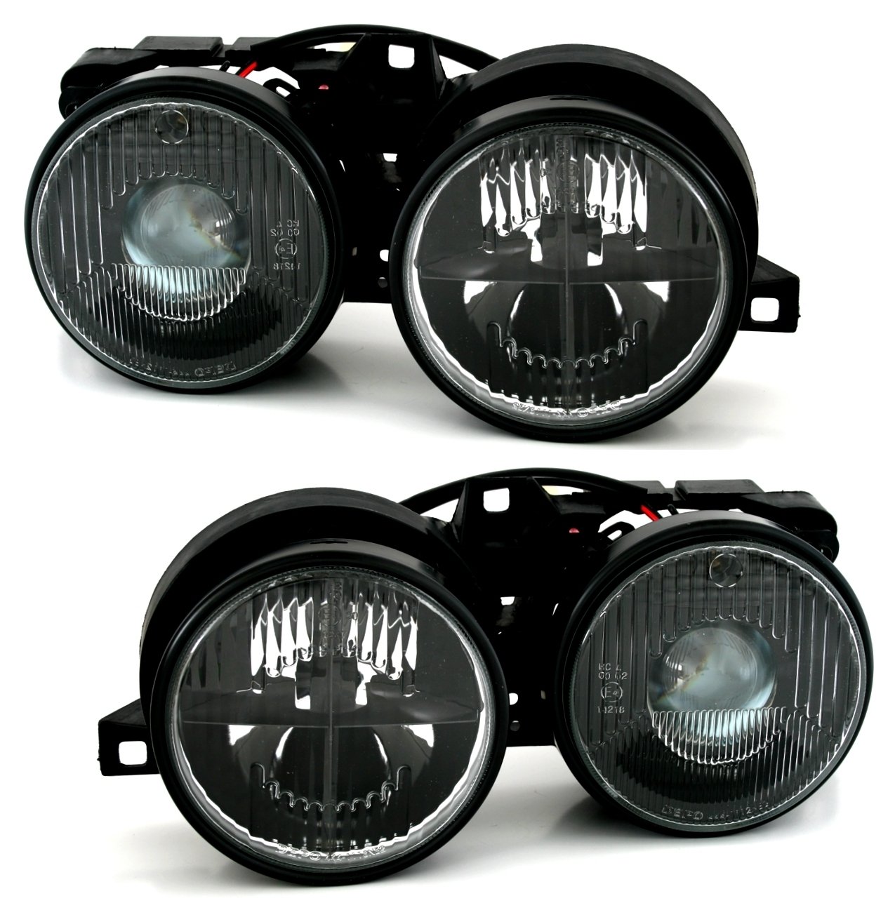

Ideally, they got an "E"-Stamp.
The headlights on this photo got them if you look closely, a small "E" in a circle stamped into the glass.
That means I can either just install them and go, or they come with the paperwork needed to get them approved.
If a headlight/rear does not have that stamp I could have paperwork created to get a chance at having them approved, for a set of rear lights (didn't research headlights yet) that'd be 6.000 Euros, with no guarantee to get them approved.
There are LED headlights for Harleys that have the certification (they start at about 450€ per piece), but it's a "gray area" since no-one says that "E"-certification for motorbikes also allows them for cars, but no-one says it doesn't either.
