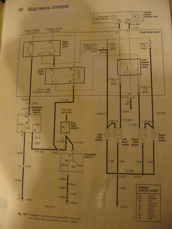

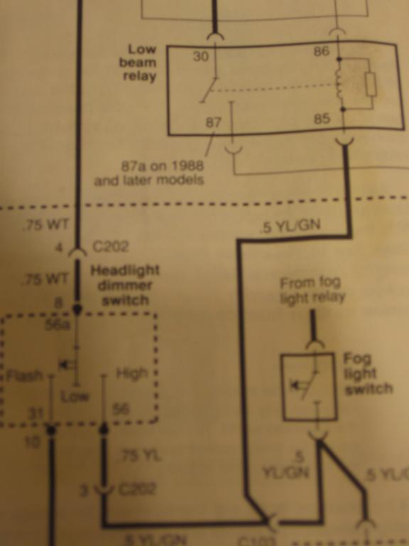

          ok, I looked a wiring diagram/schematics from Bentley, and it shows there is a high beam dimmer relay or switch located somewhere. Not to be confused with the dimmer on the headlight switch for the interior. I didn't test the fogs yet as suggested but I am wondering where it is and what this switch does? I threw some pics up. The part is in the left of both diagrams
          • DaveSmed
            • Apr 2007
            • 1407
            Thats the nomenclature they use for the switch on the turn signal stalk.

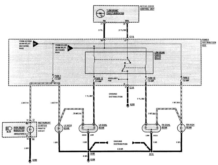

                Anyway, the two switches control the lighting via ground side switching. One interesting thing I see is the fog light relay is supposed to have a diode in it (the only relay like it on the car). I think its to prevent the fog light relay from engaging when the button is in, headlights off, and the dimmer in the high beam position.

                          Take a look at the below diagram, and consider power going backwards through fuses 13 and 14. That would explain that behavior exactly.

                            ok, this diagram seems to be a late model because you have the active check control unit as a separate relay. now I don't know if this actually makes a difference or not so I'll just go along. :-)

                              It shows it that way, but every year has it on the circuit board. From my '84, my '87, to my '92. The relay wiring is what really changes, and surprisingly, the ETM is not %100 accurate. FWIW though, that pic is from the 1987 ETM from BMW.
                              Anyway, the exact scenario you mentioned in post 12 was fog light switch on, check control warning OFF until insertion of low beam fuses, and check control+dim low beams upon insertion. I get that right? What position was the headlight switch in? All the way out, or first click?
                              With the low beams on dimly, now that you know they go out with the fuses pulled, find out which relay(s) makes them turn off. K3, K4, and/or K8.
