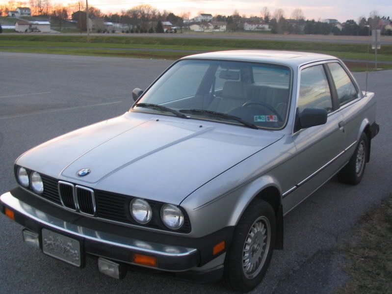

    So a while back my foglight bolt on the driver side rusted and broke off during removal. So i disconnected them both and removed them completely. Now i have no fogs and i'm left with a switch that does nothing.
    The fog light switch still works and i want to do something with it. Maybe wire it to the high beams and run low power to have some makeshift city lights. But the problem is, i wouldn't know how to do that :(.
    Does anyone have an idea as to how i would go about making these work? I've got Smileys, btw.
    Or i can just place the fogs back onto the bumper but i dont want them close to the center of the car, i'd like them further apart, under the low beams. Have any of you done this before? (I know i've seen it before)
    I'd like to go from this: http://i41.photobucket.com/albums/e2...lLeftFront.jpg
    To this: http://www.dtmpower.net/forum/attach...ates-photo.jpg
    (also wondering where i can get this valance:grin:)
