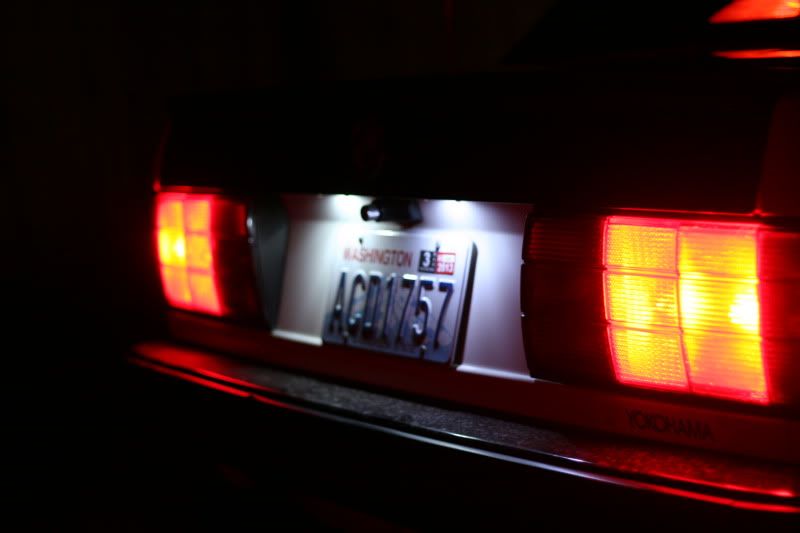

    Got my car setup over at V-LEDS here in Bellingham, WA. Pretty much replaced everything except the dash lights and the 2 center console lights.

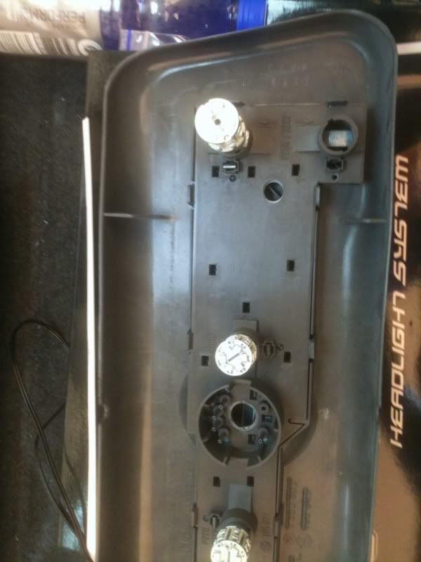

    7507 - Back up Lights (Need to retro fit back cover to make sure these turn on, flip positive and negative tabs bulb is directional also. No check panel light.

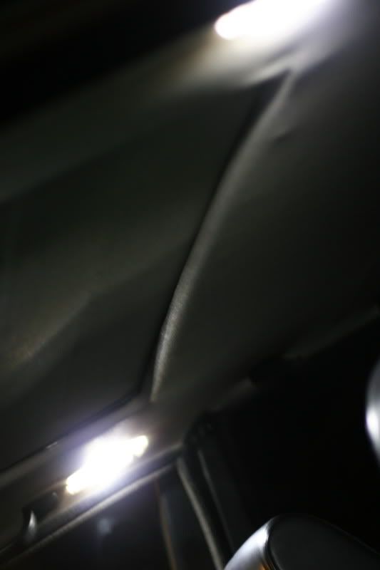

    74 - Interior lights. White & Amber

    I have smoked taillights and its still brighter than stock. My bulb output is 4 on there brightness scale. These are super visible during the day.

    I upgraded the tail lights and rear running lights to a newer bulb.
    Accidentally broke the old ones when replacing my back covers.

    how are they when lit up?
    Build thread
    Bimmerlabs
    • rares
      • 730
      Oh wow, please post some pics when u can. Dang, thats awesome. I am curious what it looks like.
      • SimplyDope
        • 1335
        Curious to see what it looks like lit up and installed as well.
        • george graves
          • 19997
          Generally, they looks like a bright dots - not the even illumination that a normal bulb gives you.

                              Pics of interior LED bulbs?
