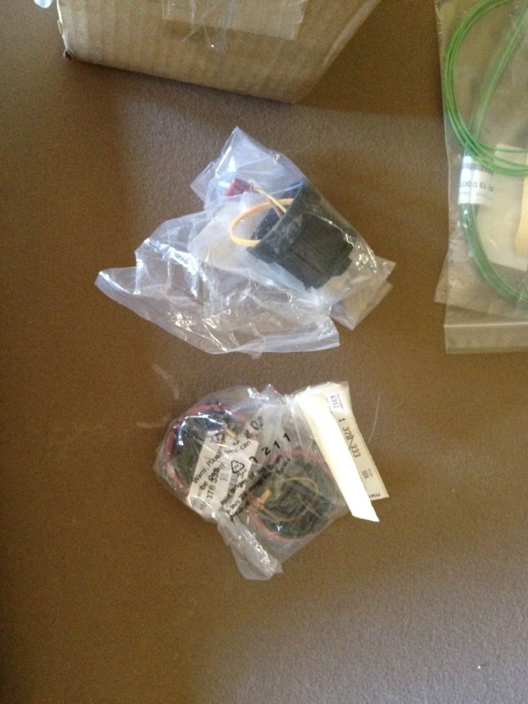

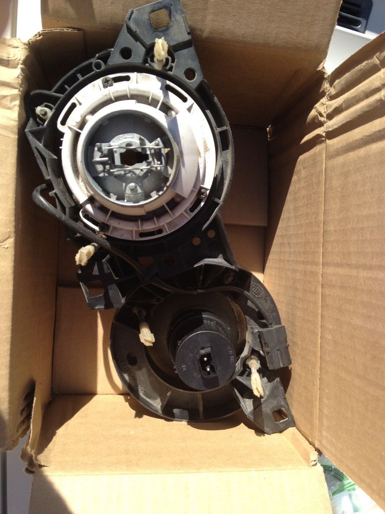

    Hey guys! PIcked up a set of Frenchies! my buddy traded them for a set of e34 smileys and also he gave me a box of pigtails and caps
    I need some help as to how to hook these fuckers up! I am new to the non us ellipsoidal setup!
    I know I need bulbs but how else do I got about hooking these up properly?

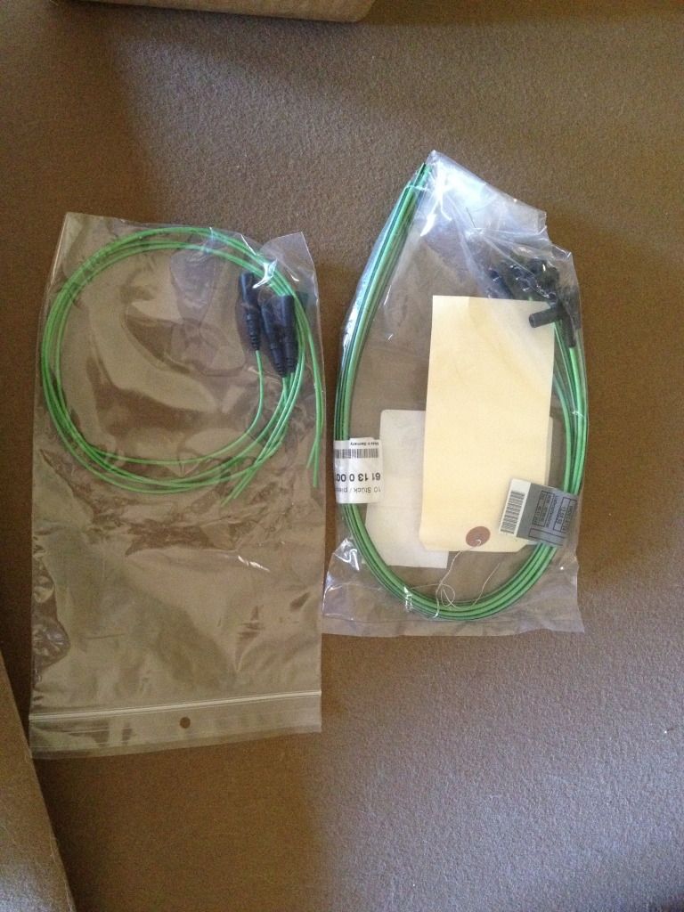

    This is all that I have..

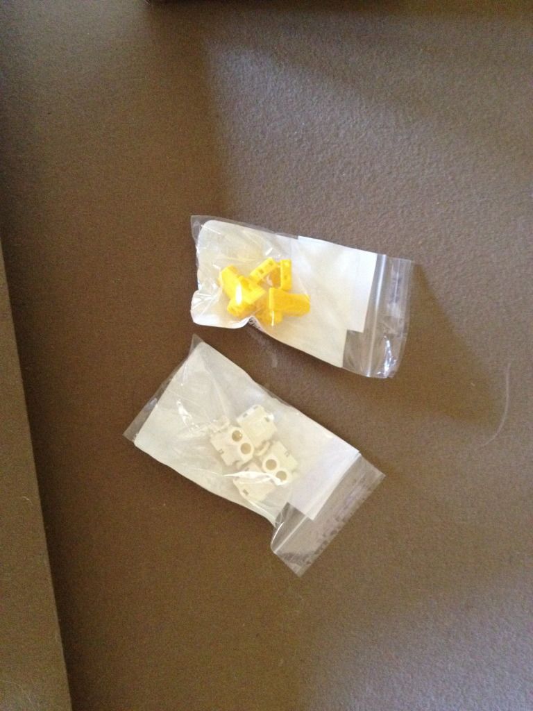

    I know how to hook the caps up once the bulbs are in place but wondering what I do with the rest of the wires?
    sorry if this is all dumb questions but I don't really get down much with wiring!
    thanks!
    //Austin
  • davem
    • Jun 2010
    • 705
    those wires go into the white and yellow connectors (they open up), then plug the connectors into the lamps and wire the wires to the harness in your car. on these cars the black/brown wire in the harness will be ground so the other wire is a hot one.
