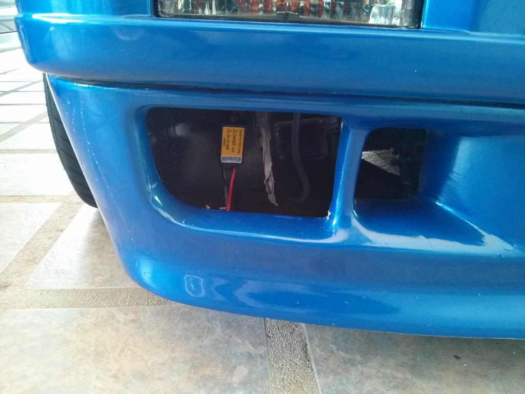

    I have a '88 vert that I converted to Mtech2 bumper.
    I ordered a set of fogs with the supports but just realized that I dont have the part where the fog mounts to.
    Where does part #8 goes to?
    TIA

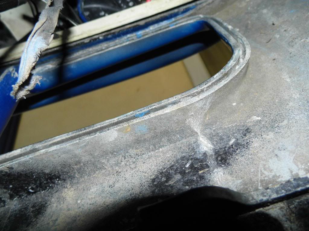

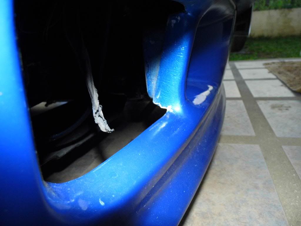

      I have everything on my first post pic. Here are the pics back of the valance where I dont see what would hold the fog lamp in place.
      This is the back of the valance. Where I cant figure out where to mount the fog lamp unless I'm missing something.

        Looks like you are missing the stock metal valence. That is where the fogs would normally mount. Someone cut way too much of the stock valence when they installed the MTech kit.

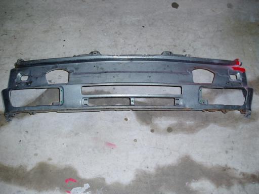

            This will make better sense....you have an 88 VERT. Those don't come with the facelift valance that these fogs mount to. The M tech 2 front spoiler is just a cover that goes over the existing facelift valance. What you can do is remove the bumper, get the valance, paint upper portion under the grill and slap your bumper/spoiler back on. If you don't want to do that, you will have to fabricate a bracket system that will hold those fogs in place.
