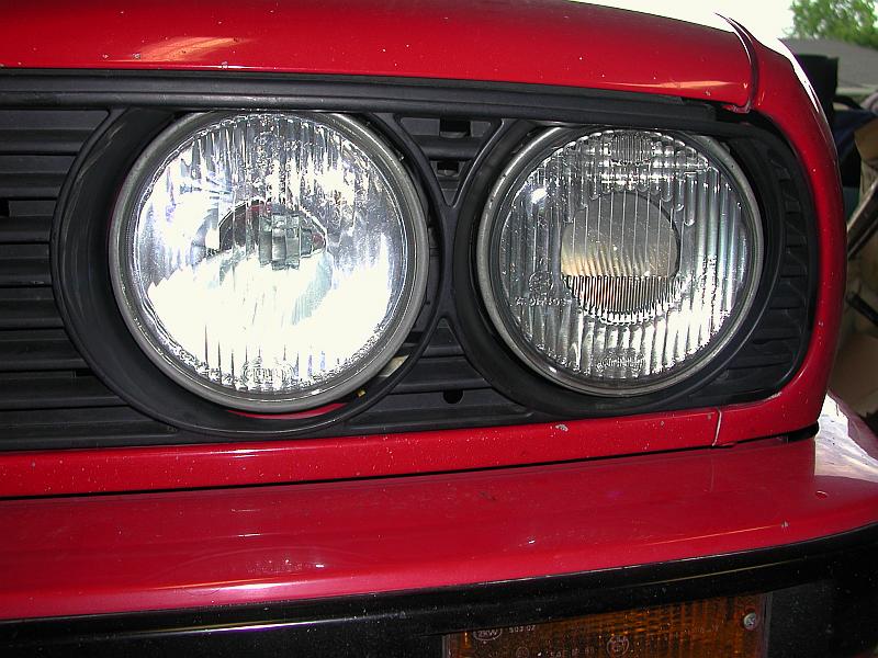

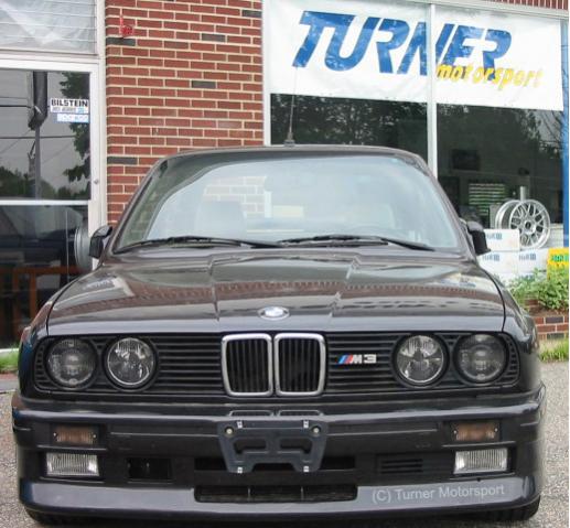

              Ok so yes there is some aesthetics to the different lights.
              So US market lights have glass lenses and look clear in nature.
              The key with Euro lights is the "smile" in the bottom half of the lens. This has to do with the euro standard on light dispersion.
              Then there are smoked euro lights look black when not on.
              Below are a pic of each. Mind you the euro clear lights the owner has tinted the highs.
              sigpic"If one does not fail at times, then one has not challenged himself." -Ferdinand Porsche

                Originally posted by bmwguy325is
                YOU ROCK!
                The first set of lights you posted are Euro nonsmiley lights. You can see the City lights in the low beam.
                With the euro lights the cut off will have an up kick on the end like this
                Where the US ellips will be kind of flat
                  Thanks sorry Im on a small screen. Looked like an example of US lights.
