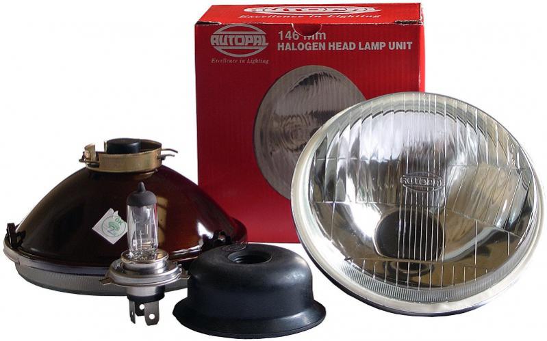

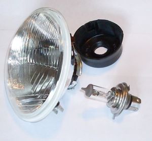

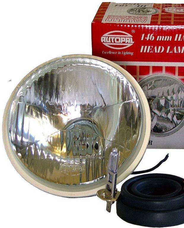

                        I know this is reviving an old thread but, I too am searching for a replacement lens for the sealed beams that allows me to use replaceable H1/H4 bulbs and still retains the OEM look convex lens.
                        Autopal makes a convex lens 5 3/4" "E" code H1/H4 sealed beam replacement . These are a similar design to the Hella, Bosch and NLA Cibie lights. The light has a metal reflector and glass lens, though I have heard that the glass is thinner than that on the Hella and are made in India. I am running the flat version on my M6 and couldn't be happier.
                        http://www.ebay.com/itm/331772911024...%3AMEBIDX%3AIT
                        http://www.ebay.com/itm/331773193332...%3AMEBIDX%3AIT
