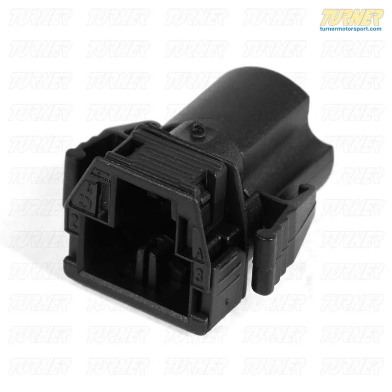

    Plastic Bumper Turn Signal Plug
    Yes i've researched the fuck out of this and came up with nothing.
    I need new front turn signal plug housings that come up as part#61131378410 (which is the wrong part) that are for 90 degree wire boots in the 1st pic (male). They go to the 2nd pic (female). But the wiring boots on my car are angled 90 degrees and are not straight (3rd pic). The new housings are meant for the straight style wiring boots.(4th pic) Does anyone know where I can get the correct housings for the 90 degree style wire boots?
    Wrong part for 90 degree wire boots. (below)

      They’re NLA & you don’t need them just put the 90 wire boots to the correct pins on the turn signal

          The 412 - 3 pin 90 degree housings have long been NLA but the connectors are available. The 410 - 3 pin housing is available but the straight connectors are NLA! This puts us in a bind as used connectors are now 20-30 years old.
          I don't think they sell the white socket separately. They make a 2 pin (Euro) and a 3 pin (US) housing.

            I ended using e36 corner housing connectors with wires cut from the pick a parts recently since mine were toast. I only hooked up two of the three wires to emulate euro lights and only come on when my turn signals blink.
            I have extras in anyone needs a set.
