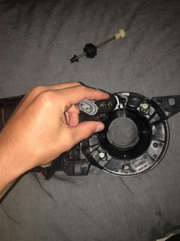

    US Ellipsoid to Smilies Help
    So I've searched on how to properly do this conversion but ultimately just keep ending up with tutorials on how to go from sealed beams to euro smilies. I just got a set of Depo smoked smilies and really want to figure out how to properly wire these up. Im confused as to if they're plug and play because I already have US Ellips, or if i need get female connectors to wire them up. Could someone please list what i need in terms of parts to properly do this, or redirect me to a detailed thread showing this. Also, if anyone is in the San Diego area id appreciate the help if you could show me :)
  • HooptE30
    • Jun 2016
    • 57
    The top two are the high and low beam connectors (black & Gray) and the bottom is the city light (black connector with larger prongs). Not sure if this helps
    • ELVA164
      • 4861
      You have the right wiring, you need the correct plugs on the chassis side. You'll also have to tap into a running light if you want to use the city lights.
      • HooptE30
        • Jun 2016
        • 57
        Where would i get the correct plugs on the chassis side? I'm assuming it would be as easy as splicing the wires and tripping/soldering the new ones on? and i was thinking of connecting the city light to the side markers, but I'm not sure how to on that one either
        • ELVA164
          • 4861
          Actually, those plugs look different than the ones on my Bosch smilies. You still have to match them, just not sure what they are.
          • ELVA164
            • 4861
            Just cut the plug off the car, attach the new plug to the wires (making sure the wires are correctly matched!), and seal from the weather. You splice the wire from the city light into the wire from the running light and seal that as well.
            • reelizmpro
              • 9557
              You have everything you need. DEPO's harness is made for cars with US ellipsoids so do not cut your 9006/9005 harness. You just need to make sure of the polarity before you put the 2 female terminals over the males and make sure they go on snug. This harness is DEPO's way of making it plug and play for cars with US ellipsoids but they cheaped out by not providing water tight female terminals inside of the proper connector. I wired up them as is and haven't had a problem but the right way to do it is order the proper watertight terminals and connectors $.
                Being that we're both from socal, you understand the whole rain situation haha. do you think i could get away with plug and play and then wrapping a little duck tape or electrical tape over the adaptors? id assume the fuse would go out if any water did happen to get in, right? also how much would it be to get new waterproof male and female adaptors?
                • Das Delfin
                  • Sep 2014
                  • 2293
                  I live in rain country and electrical taped my smileys with butt connectors. Still good
                  • reelizmpro
                    • 9557
                    Sure you can. Taping the connectors down is a good idea. For all 12 female terminals with wiring @ $5-7 each + connectors but like I said, it's not a big deal where we are.

                        Polarity doesn't matter on a light bulb. It will work either way.
                        • HooptE30
                          • Jun 2016
                          • 57
                          Got them installed last night, Thanks for The info everyone! Got a pair of US ellipsoids for sale too now if anyone wants them haha
