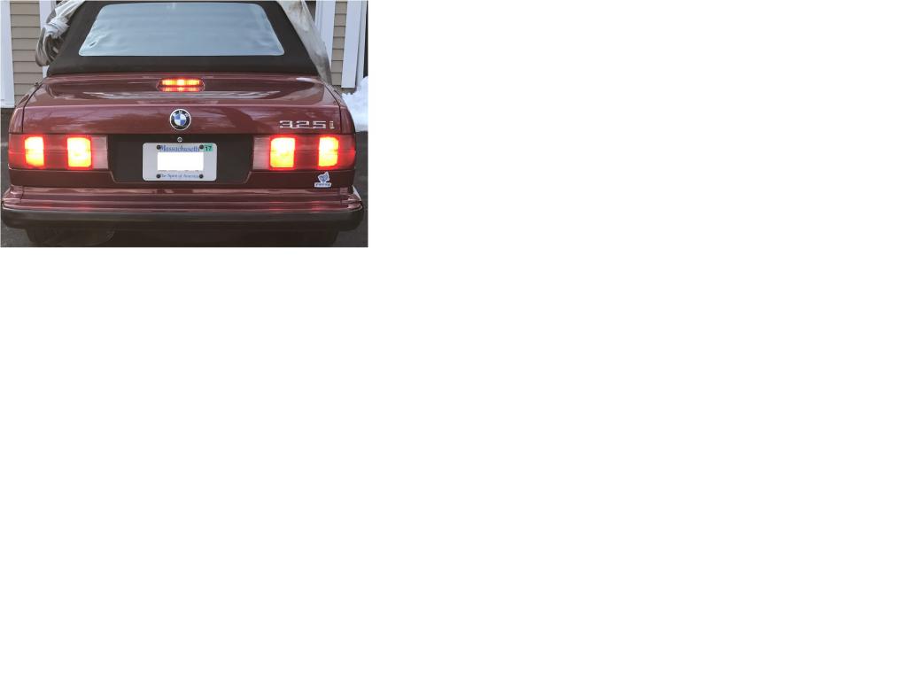

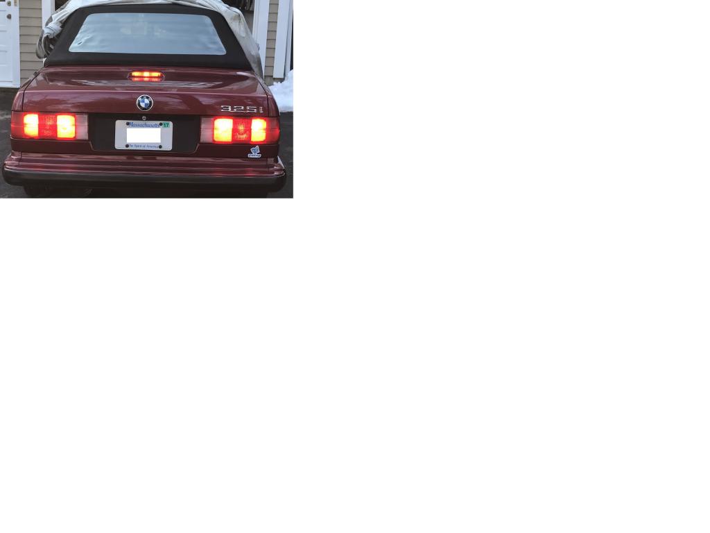

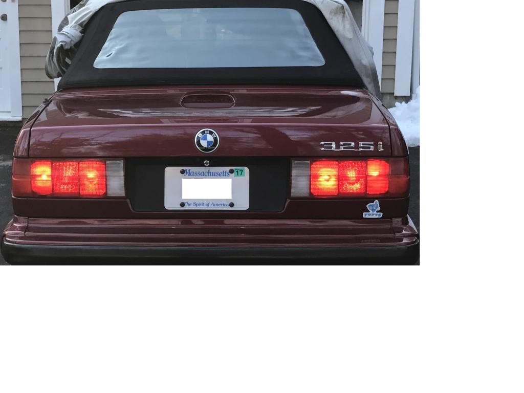

              OK, here are the pictures
              Hope these load, I shrank them 50%.
              Pictures are titled by what is lighting.
              Hope this helps show the potential for E30 rear lights. Both the tail and brake circuits power the extra lights using a relay to save the stock wiring, switches and fuses from the extra load.
