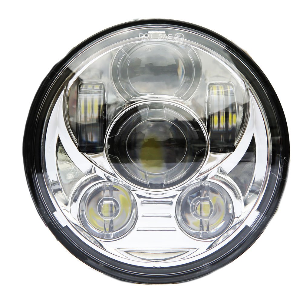

                      • Kershaw
                        • 11822
                        https://www.amazon.com/gp/product/B0...?ie=UTF8&psc=1
                        These will plug right in to the stock sealed beam harness. They also fit perfectly in your car. But you will need to cut up your headlight housing.
                        AWD > RWD
                        • Mo Brighta
                          • 429
                          They also fit perfectly in your car... you will need to cut up your headlight housing.
                          I'm confused - is this cutting up of the headlight housing a trivial matter - or does it mean they don't fit perfectly until you do so?
                          Do you have a set of these? I'd love to see a comparison, A to B, of the beam pattern against a white wall, both lights aimed properly, with a constant camera setup - same aperture, exposure time, etc. This would be very helpful - making a visual comparison - so we could perhaps consider them with good information.
                          Amazon isn't going to provide any, that's certain.
