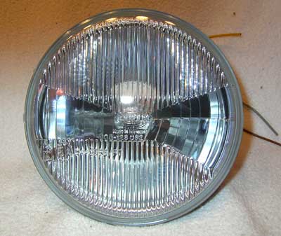

                  Headlights are in! Check out some pictures here I'll get them installed this weekend.
                  They're really well built. All glass and metal, and look hand assembled from the way the sealant has been applied. Just by looking through the different parts of the glass to the back of the unit you can see how its designed to manipulate the light into different directions.

                    Thanks for the pics!
                    Is there a pigtail or socket to hold the citilight? Also, is there a rubber boot or something to cover the electrical connections (at the back of the light) when all wired up?

                      What are in those first pictures is what it came with. It has a retaining piece of metal for the city bbulb like it does for the H1 light, which will at least give it ground I think, but I haven't found exactly what city light goes in it. I'm in California for the summer so I'm going to wait until I'm back in Atlanta to mess with wiring up the city lights, if I ever do. I've updated the album with pictures of the wiring I'm going to be using for now. I used some crimping connections to be able to hook it up to the stock wiring harness without cutting anything, and the ground is held firmly against the H1 bulb by the retaining spring metal that holds the H1 into the socket. It didn't come with a dust cover, so I'm going to look into protecting the back once I get them installed.
