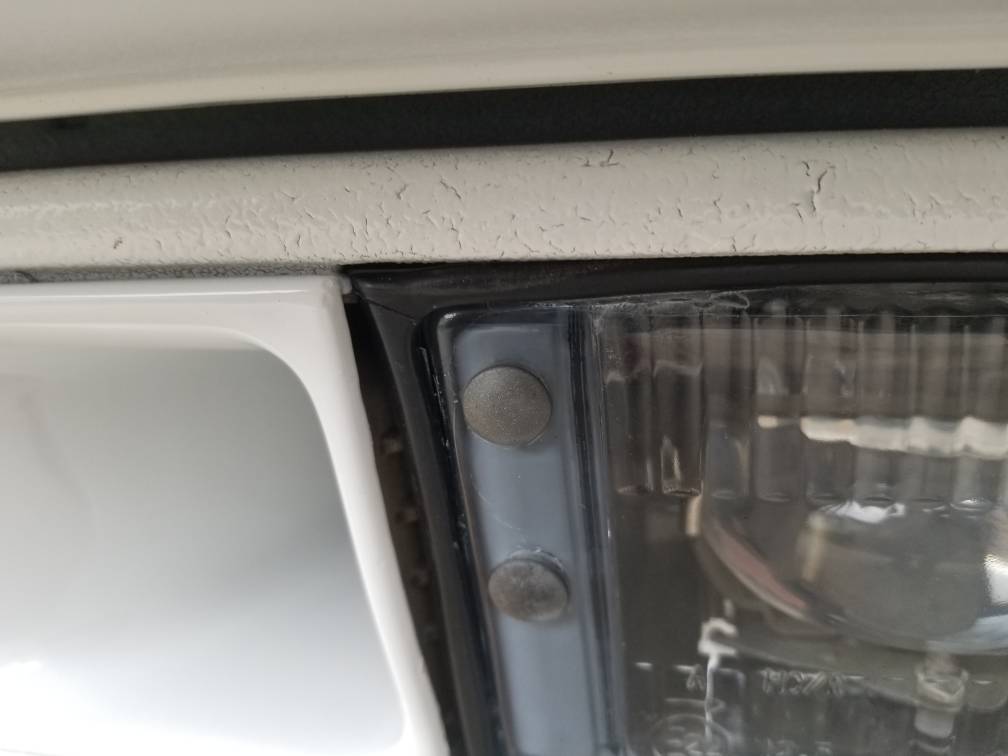

            This just ain't working out. Is this gasket all that important anyway?Click image for larger version

                    Between bent mounting points/other bends in the valence, distorted plastics/rubber in both the duct/fog/gasket, and insufficient adjustment it's almost impossible to get the fog to fit and be aimed sensibly.
                    Your install looks fine if the aim isn't bad.
