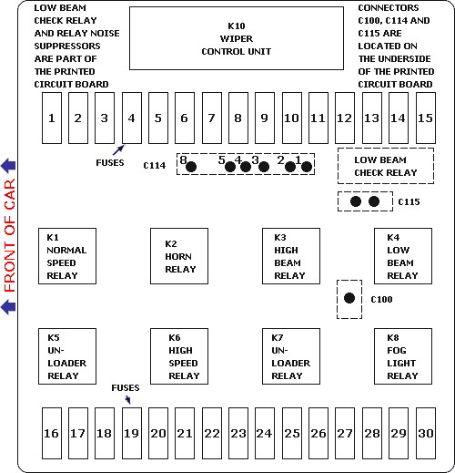

have you made sure the relays are positioned correctly? -
Low beams work fine. The highs blow only when you turn them on, I think it's the same for the fogs. The only thing on the fuses that blow are the high beams or foglights. (L high beam, R high beam, L fog light, R fog light.)Comment
Oh, and the relays are positioned correctly as far as I know (everything worked before and I don't recall switching them around). I'll look into that though.Comment
Bumping this thread up. I'm having a hard time finding good solid info about which relays are which. The info in the bentley conflicts with some things that I've read online, and I still don't know what's causing all these fuses to blow.Comment

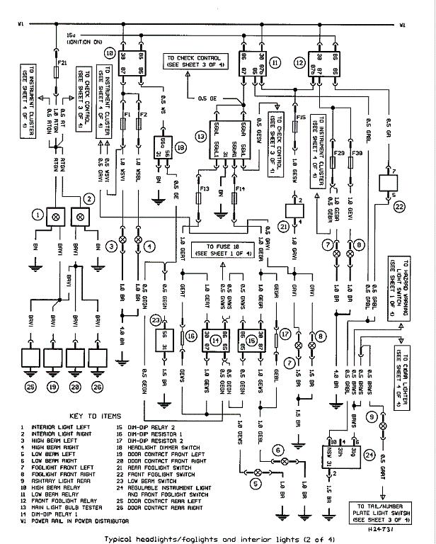

Well, first, here you can see the wiring layout, I know you must have the relays right, so try checking the wiring. If you check closely you will find the fuses and their amps values.
First try checking if you have a short, turn your high beams on and hook an ammeter instead of the fuse so you can read the power flowing through the line, that value should be less than the value in amps of the fuse, if you replace the fuse for another of higher value this could solve the problem, but be careful, if you go too high you might overheat the wires, maybe even melt them.
If the value is too high you might have a short.
If your value is correct, then you can blame the relay.Comment
