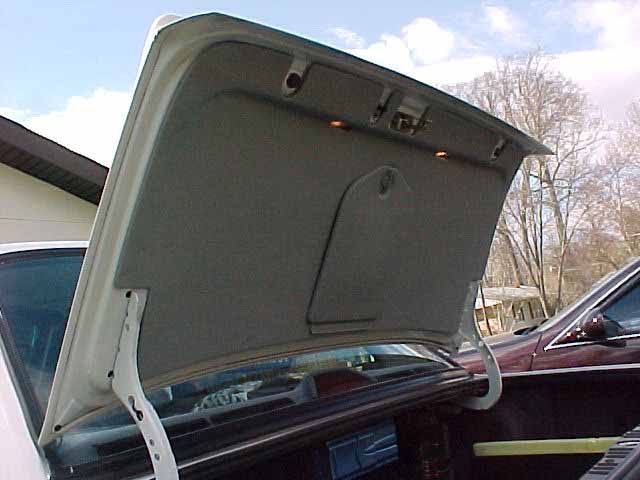

                        And you know they were originally meant to have two lights, because the trunk lid liner already has the cut out for the second light:
                        It's a crappy pic, I know, but you get the idea.
