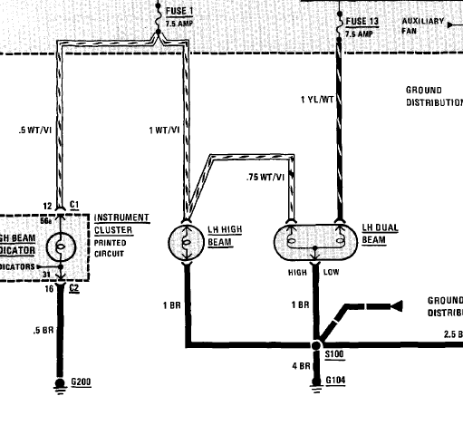

    If you haven't fixed this yet, be sure to check the prong on the light bulb. When I installed these lights, I remember one of the prongs was contacting the headlight frame and causeing it to short out every time I would high beam.

      Originally posted by Sam Cogley
      As long as the bulbs are still DOT 55/60 on the H4 and 55 on the H1, I can't see why they'd need bigger fuses. Should be pulling the same amount of power.
      You'd think so, but I definitely remember Hella's instructions saying to put 10A in (and it looks like at least one other person recalls that also).

              as soon as i started running any aftermarket lights i had to upgrade to 10A fuses in the box. i have been running 10A in there for about 3yrs, my wires arent melted.

                10a's are working great.

                      Maybe if the wiring installed was just marginally big enough for the current flowing along it. The headlight wiring in an E30 is plenty heavy to carry 20a of current instead of 15a.
                      BMW's obsession with 7.5a fuses is rather odd. They aren't even all that easy to find for replacement purposes.

                        i have the h4 set up and i never changed the fuses...still 7.5A ...BTW they work great! no probs with them 2 years in

                          Yea, even if it was wiring meant for 7.5A, they always leave some room, an extra 2.5A wouldn't matter. I just thought it was humorous that he was talking about how it was dangerous, and here I am reading about someone using it as a fix.

                            Originally posted by cferb
                            This is funny, my electrical engineering teacher was just talking about this exact scenario, replacing the fuse with a higher amp one, and how stuff's gonna catch on fire.
                            Sounds fine in this case, it's just funny to me.
                            Yes. That's true, if you just increase fuse size without calculating anything, you'll run into problems.
                            If you are installing Hella H4/H1 in the place of stock sealed beams, you need to increase Fuses 1 and 2 to 10A. It has to do with the power switching arrangement. In a sealed beam car, the low beam has two filaments. On low, Fuse 13/14 supply the power. When you flick the highs on, it lights both the high beam AND the second filament in the sealed beam through Fuses 1 and 2.
                            When you have a 55W/60W H4 bulb and 55W H1 bulb lit, you have a demand of 115W on Fuse 1 and Fuse 2.
                            P=IV and if P=115W, V=12V, then I=9.6A. So you need a fuse with a rating of >9.6A. That is why you need a 10A fuse.
                                There's a slight problem: the H4/H1 bulbs and the stock sealed beams should have the same wattage rating on the same switching arrangement. It doesn't make any sense that the H4/H1 setup would blow fuses that way.
