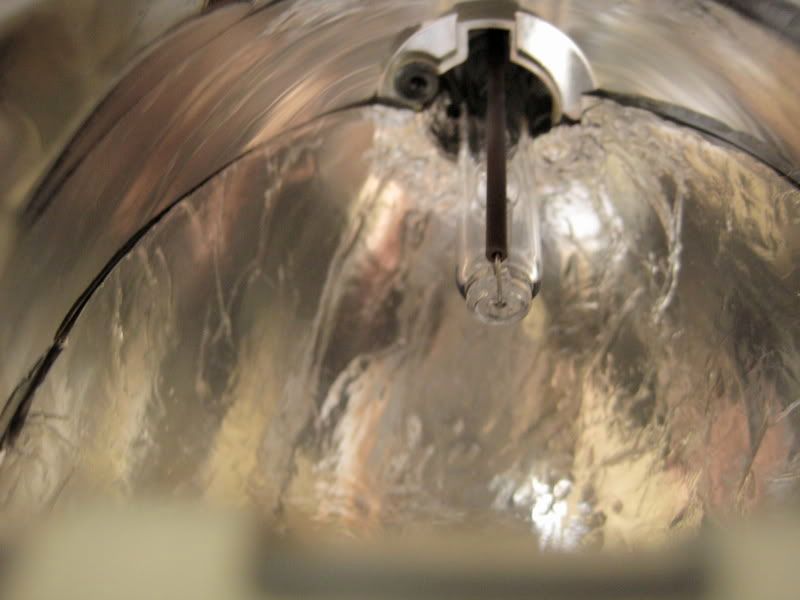

                        • 91 318is
                          • 1175
                          removed the projectors today, think I may have found the problem, you be the judge. Also checked the grounds, less then .5 ohms
                          Also, the metal tabs for the cutouts, are they suppose the same? Meaning they are cutting light off in the same direction? I would have thought between the passenger and driver side, they would have been different.
                          Looks like I'm going to the dealer this week and get new ones.

                          • ///M42 sport
                            • 3952
                            This is a problem people seldom bring up. Everyones so excited about buying used smilies for $200 from euro then they overlook the fact that lights are around 10yrs old or more. I bet smilies are about $20 from the junkyards in europe. I wish the sellers would at least check the reflectors before they resell them for more than 100% profit. I've know when all said and done, it would have been CHEAPER for my to buy NEW smilies instead of restoring the old ones I bought. To break down the cost of restoring, about $8/ adjusting screw so about $64-$96 depending on how many screws you want to replace. Then cost of new reflectors I'm guessing $100+/side. Then cost of restoring lenses $20?. So $200 for lights, $200 for new reflectors, $64-96 for screws. Even after this you still left with pitted lenses. This makes the $500 for new lights sound like a deal.
                            Oh yeah and dont listen to the BS that replacing the halogen bulbs w HIDs will solve your lighting issue. My reflectors were mildly pitted. After installing HIDs, I only made the output comparable to my sealed beams!!!!!! I'm resorting to my aluminum foil getto fix for now which seems to work well.

                            • 91 318is
                              • 1175
                              Well I guess I should have researched more before I bought used headlights. Although the little reading I did, I don't recall coming across a thread about dull reflectors.
                              If I would have known that they dull out and new one's are another $200, I probably would have bought new smoked hellas.
                              Anyways, we have 3m aluminum tape at work that I'm thinking of trying out to see what that does. Otherwise I guess I'll have to get new reflectors.
