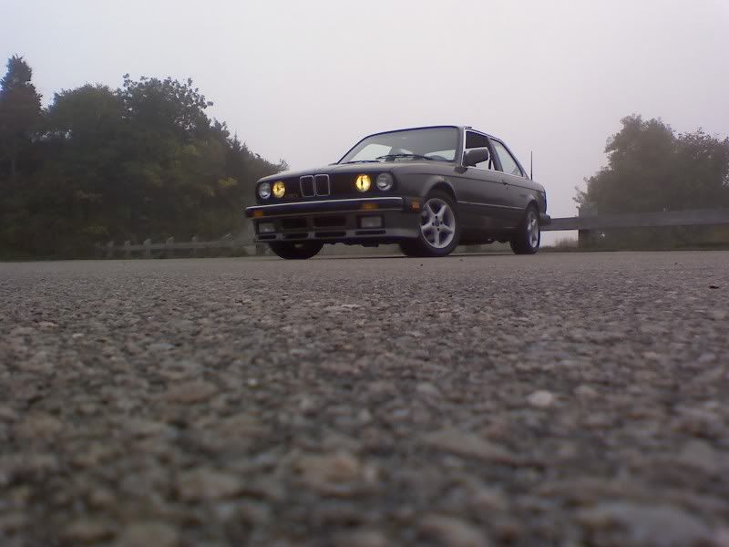

          i use them as fog lights i got the yellow ones
          heres the only pic i have right now of them on,
          b4 euro bumpers
          pm me if you have anymore questions about them
