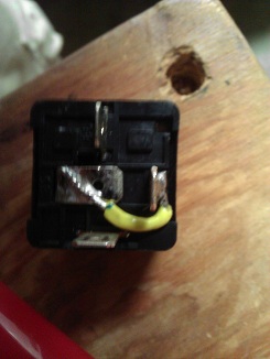

                Tried jumping 87 to 30 on k4; didn't work but made my low beams come on the instant the relay touched the socket. Tried the pictured work around with the k8 relay (bend 85 and jump it to 30) using a non-modified k4; nothing.
                09/87 325 (face-lifted)
                Any tips?
                EDIT: After giving up, I installed a new headlight relay and decided to use my old one in place of my now modified-foglight relay. So, after un-soldering the wires from the terminals, I put it (the orignal headlight relay) in the foglight socket and lo, the fogs now come on whenever I want as long as there's keyed-on ignition. Durrr...
                Part # for similar relay to the one I used: 0 332 019 451 (bosch relay)

                    #39
                    Brezzi, I don't know if this will work the same on your car but i'm 90% sure it should. Just use the Bosch part number I supplied above, should be around $10-$15 at your local car quest, auto zone, etc. Just your basic 4 prong headlight relay, placed in your foglight (k8 ) socket.
                    http://forums.pelicanparts.com/uploa...1205159805.jpg
                    Your old relay
                    Your new relay
                    Good luck, hope this helps!

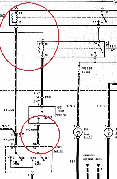

                            The 318is Wiring is a little different but similar in ways.
                            It only has one 5 pin relay which is high beam.
                            Low beam and fog lights have 4 pin.
                            Also fog light switch has 2 wires not 3.
                            Shown here in this diagram below.
                            Basically the same concept just have to do it in different spots.
