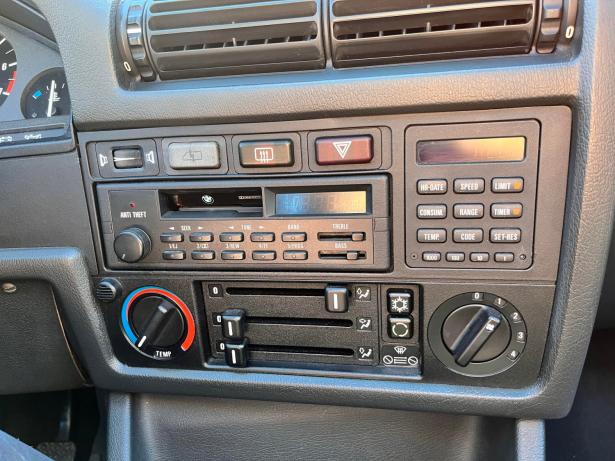

    Bricked radio, possible? Correct code doesn't work anymore.
    Hey guys, this is my radio in my 87' 325is... Took the car out of storage, entered the original (good) code for the radio and couldn't get it to work. I admit, I tried multiple times, probably too many....I removed the battery for 2 days, tried again, still nothing. Left the ignition and radio ON for over an hour, then another time for an entire day, didn't work...Tried for 4 days with radio ON, nope.
    I think I've tried everything I could think off but nothing work. Can a radio be bricked after trying multiple times ?

      I believe the radio user's manual says something about three tries. Then you have to wait 1 hr before you can attempt again.

            In this situation it would be easier to connect it on the bench, so you dont need to wait with ignition on in the car.
            Yes, disconnecting battery wont help here, either you will have to wait for it to have access again for code input or you will have to give the unit to someone who know how and can read/clear code from eeprom itself (in the unit, soldered on pcb) or just write new dump in it.
