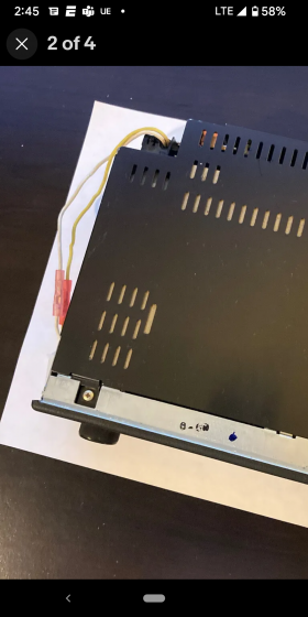

    CM5907 power cable cut. How is the cable attached to the radio internally?
    Is the cable soldered inside the radio, or does it simply plugged into the radio internally, in a way that I can simply buy a donor radio, take the cover off of my radio, and plug that uncut cable into my radio?

    please post a pic hard to tell what you're talking about. if it's that the power connector was cut off, you will need to replace it.
      Thank you for the response, I am referring to the attached photo. I know the resoldering will most likely not affect anything, but I still rather replace it with an uncut cable if possible.

        Those two wires are for the radio lighting. You will need a replacement connector to hook them up to your car. is your car wiring for the radio complete? there's a black connector for radio power.

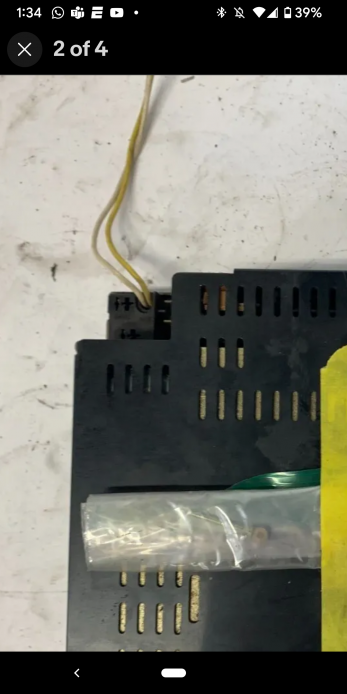

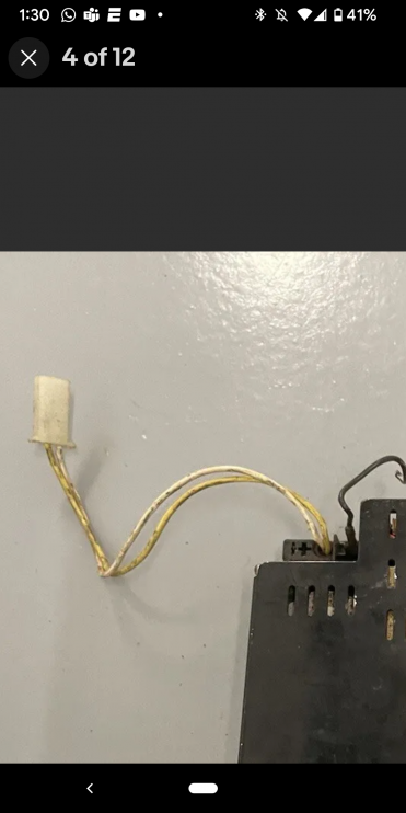

        • IS300E30
          • Apr 2009
          • 408
          Your view doesn't look like it will work on the CM5907, if you look at the updated example photo that I am attaching, it looks like that cable is embedded into the radio
