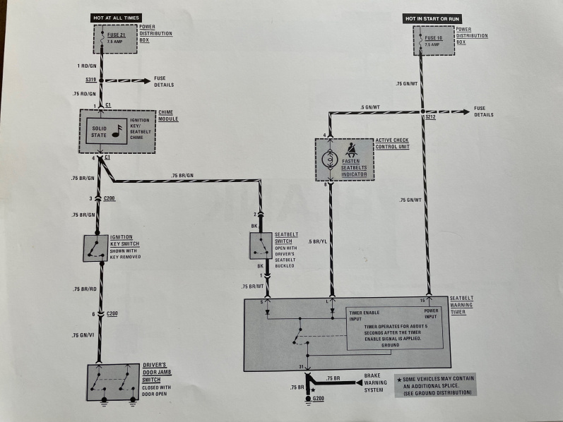

    The gong chimes under two conditions, both require the ignition key in: an unfastened drivers seatbelt (6 seconds) and (continuously) when the driver’s door is open.
    Does the chime come on for approximately 6 seconds when the drivers seatbelt is unfastened, and the ignition key is put to run position? This chime should be independent of the door jamb switch status.
    There are two contacts on the drivers side door jamb switch, both ground their respective wires to the ignition key/seatbelt chime (green/violet) and the interior light control unit (brown/yellow). The switch can be removed (one screw) and cleaned of years old dirt and grime. You can easily test if both contacts are grounding by switching the two wires and see if the lights still come on when the switch is in the open position.
    if the door switch is working properly, then the fault may lie in the wiring between the door jamb switch, the ignition switch or the chime module wiring. This is illustrated on page 6131-0 of the BMW Electrical Troubleshooting Manual, and can be investigated with the aid of a multimeter.

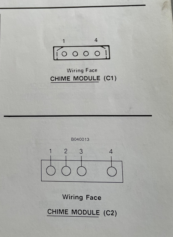

    This all assumes you have a working gong. You can test that by insuring you have 12V power at pin 1 of the chime module connector (C1). If so, with the gong disconnected, jump pin 1 of the connector to where pin 1 inserts in the gong, and simultaneously jump where pin 4 inserts on the gong to ground, should cause the gong to chime.

        Wiring diagrams from 1990 BMW 325i Electrical Troubleshooting Manual, P. 6131-0 Ignition Key warning/ seatbelt warning: Click image for larger version  Name:	IMG_0513.jpg Views:	0 Size:	148.4 KB ID:	10098205 Click image for larger version  Name:	IMG_0514.jpg Views:	0 Size:	133.5 KB ID:	10098206
