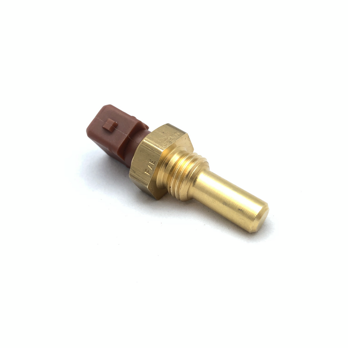

            IF YOU WANT AN EASY COOLANT TEMP SENSOR WITHOUT TAPPING THE HEAD, ORDER THIS. SAME PITCH AND THREAD AND WILL WORK WITH WIRING HARNESS.
            If you are swapping an OBD2 engine (M52/S52) in your E30, you will need to use the correct temperature sensor for your temperature gauge to work. The E30 (brown top) sensor has threads that are too large to fit the OBD2 head. We precisely grind off the threads, and rethread the sensor to the correct pitch to fit. Fo
