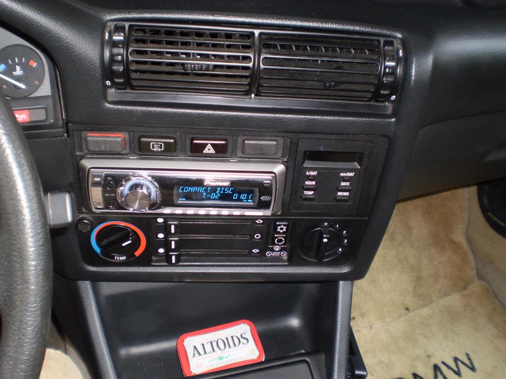

      I took care of my antenna controls by running a hot wire from the battery to the stereo area and then by removing the speaker L/R switch in the HVAC area also by the hazards,defrost and window kill switch. I got a second kill switch and replaced the speaker switch with it. Then hooked the live wire from the battery to one end with a female prong connector and the E30 antenna wire to the other prong. So now it looks BMW stock and when I want the radio I just press the switch!
      (the speaker controls are taken care of by the new deck)
      In the picture attached it is the switch on the left
