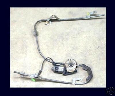

    so i have a problem with passenger side window.
    it has power and the motor running well.
    only thing that i can manually move the glass up/down but not from the switch.
    (switch, motor, everything work in order)
    here's the pic of what my regulator/motor look like
    could it be the regulator that broken so that i can move it up/down by hands?

    yea, if the motor is running, but regulator isnt moving the window, something is broken.
