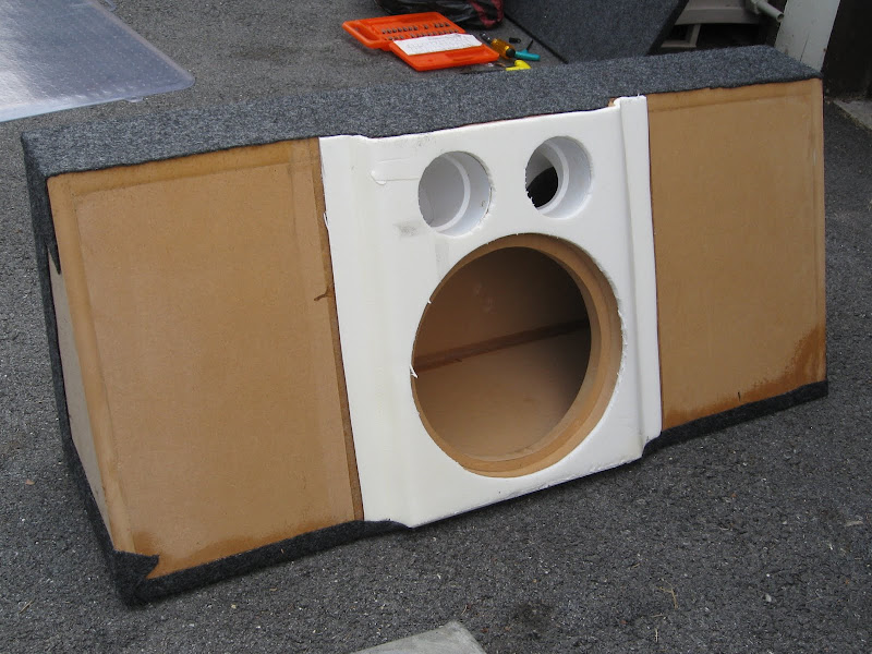

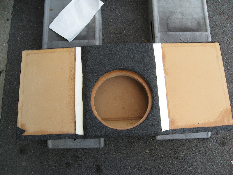

                          Here is where we are now - which is to say, not very far. Just got the connectors and crap for the wiring in this afternoon, and I still need to drill a hole for the speaker wire and mount the sub, then when I get the template work on the amp board... It will likely be weeks! ;)

                            That's a nice looking setup. It would look good with some gloss finish cherry wood and aluminum accents on the port. I'd throw a Soundsplinter Rl-i 10" in there.
                              It would, except that the part you see there is flush with the firewall and behind the back seat, somewhat like this:
