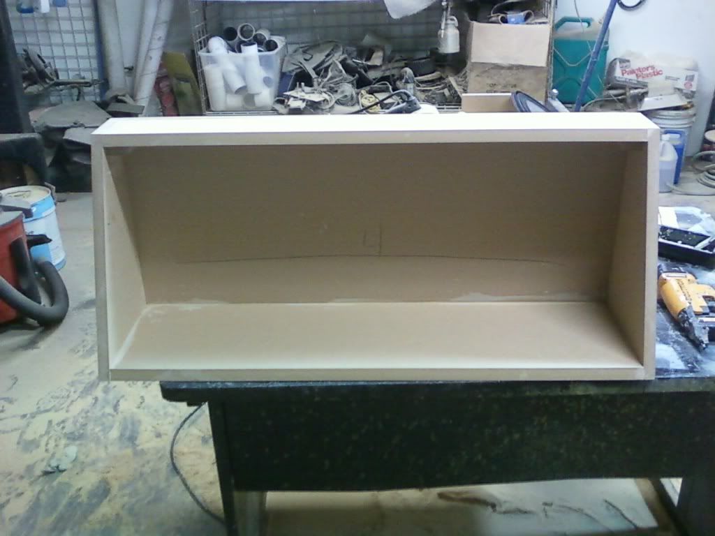

          Originally posted by jrobie79
          can you post more shots of the construction? looks great
          Well, here you go. Inside the box, before sealant. I put 2 tiny little angled bits in the upper corners to hold the face from sinking in.
          Normal bead of silicone, mushed inti the cracks with my finger (messy, but works)
          Here is a pile of faceplates. These are ready to go on
          Backside of face:
          Here is the real magic. This panel fits in the space between the 2 vertical metal braces in your trunk. This panel stiffens the box, recesses the woofer, and provides the seal. I spent weeks figuring out how to make this perfect: easy to build, easy to duplicate, inexpensive, (sort of) lightweight and to provide a 100% seal into your cabin.
          That stupid chunk of MDF is an absolute fucking marvel of engineering!
