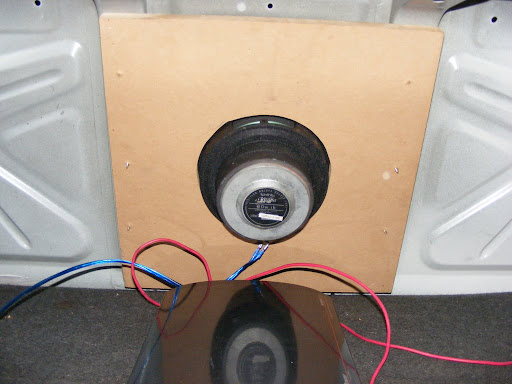

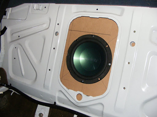

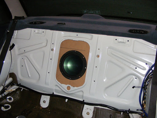

                            Update
                            Ok ladies,
                            here is the scoop: I installed the amp and sub, actually wired it up more like, i didn't tuck any of the wires away neatly or mount the amp yet since i am still in the knob-twisting stages, so here is what it looks like. Yes, it's ghetto, i am not terribly worried about my sound system, i got it all for free, i just want to make it sound the best with what I have.
                            So here is the question:
                            What should I do with the rear xover frequency knob, the rear gain knob, and the qbass knob? (see pic in first post of thread)
                            FYI: I play heavy metal like Metallica, Iron Maiden, Disturbed, etc, not rap, not country, and I occasionally will blast some good ol' Beethoven.
                            At the moment, it seems like the subwoofer cranks out Nicko's bass drum hits pretty well from Maiden, but doesn't crank out the notes of Steve Harris' bass guitar like i want it to, or the chugging guitar riffs.

                              To be honest harris uses a pretty mid/high heavy bass tone, for more punch and clarity over girth due to his playing style.
                              IMO, the subwoofer simply fills out the bottom end, and if you've got a crossover or something you're going to be cutting out most 'guitar' and 'bass' frequencies anyway.
                              Guitar in standard tune, the low E string is about 80hz iirc, and bass goes all the way down to 40 or something close, but most of that will be rolled off or cut in the mixing/mastering anyway.
                              If you want to hear more of the sub you can try to raise the crossover frequency, which will lift the cap off of what it cuts out of its signal.
                              If possible you could turn the subwoofer up via the head unit, or EQ more bass in the mix for sure.
                              The gain is going to do exactly what gain does.. basically increasing the ratio of input level : output level.
                              Qbass.. couldn't tell you.
                              From my experience it wasn't a good thing to hear guitar and most bass parts thru the subwoofer, when I turned it up it sounded real blah. Once I turned it back and refined it a bit all was well. Try tweeking the settings a bunch and I'm sure you'll find a happy medium.
